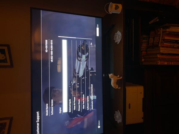

The top is what it’s saying the bottom is what is on the back of my tv, I don’t know if a factory reset will sort it I can’t understand how this has happend I have opened a case with Sony and will be ringing them on Monday

That really is very strange and something that only Sony could give an answer to.
The TV is clearly the KD-55XF7003 as the label on the back confirms and the position of the legs/ stand.

Hi @Claire75   It is difficult to scale a photograph, so could you measure the diagonal. It looks like 43” to me and not 55”. I would tend to believe what is displayed on the screen and not what’s on the label.

The real question is for your Retailer (who sold you the TV), why the label does not match the device display.
