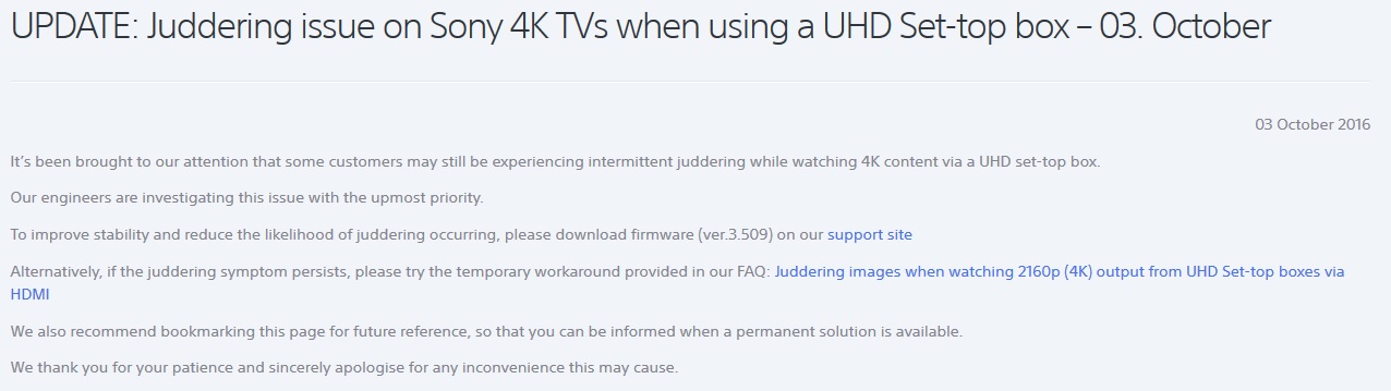

Hi all - thanks for all the informative information I have found on this community site.
I have recently purchased the above tv and I am using it with a (UK) BT Ultra HD package. The output of the box is 2160p50 and I have set it to 10 bit colour.
Generally speaking I am very happy with the telly but I am experiencing a bug which sounds similar to the "Screen Format: Full" issue reported on another thread.
After a period of watching TV (normally longer extended periods of say 2 hours), the picture starts to judder and the "Screen Format: Full" message flicks on and off. The only way to recover this is to switch the telly off and on again which seems to allow the telly to "resync". This problem happens *every* day when watching TV at least once.
It is not a problem with the BT box as when I switch that on and off the picture problem does not clear.
I have tried different 4K related settings on the telly / BT box but the problem still occurs. Has anyone else noticed this with the TV ?
Thanks,
Ian

After waiting patiently for Sony to fix the judder issue with UHD set top boxes they finally release the firmware on the very last day of the month they promised the fix would come but suprise suprise it fixed nothing. This must be incredibly embarassing for Sony not only the issue itself but also the promise of a fix which came at the very end of the month and didnt work. Whats next do we start returning these TV's obviously they cannot sort the problem which is over a year old since BT started broadcasting in UHD. Dont get me wrong I love the TV be we shouldnt have to live with this problem especially as these Tvs are not cheap. Whats next Sony your move.

Hi. I am new to this forum but not this thread as i have had the juddering problem too.
The download did not sort my tv either, sky q silver.
I had previously switched the hdmi for the sky to enhanced but after the update didnt work i have switched back to standard and for 24hrs now, no juddering.
Maybe try it.
On tv remote press home
Scroll down to settings
Select external inputs
Scroll to select hdmi signal format
Make sure on standard.
If not, select advanced and then switch back to standard.
I will post again if i get juddering and this 'fix' hasnt worked.
