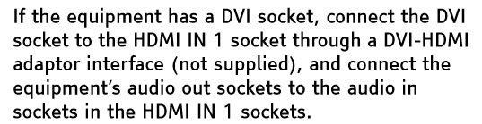

Having a dig around the manual, can you ensure that you have connected it up as follows:
If those two cables are connected to the TV, in those sockets, and you have selected HDMI 1 on the TV source input, there is no reason why it shouldnt work. If it doesnt, I can only conclude that an audio out setting or connection on your PC that needs modifying. If your PC has a line-out try using that instead?
Cheers
